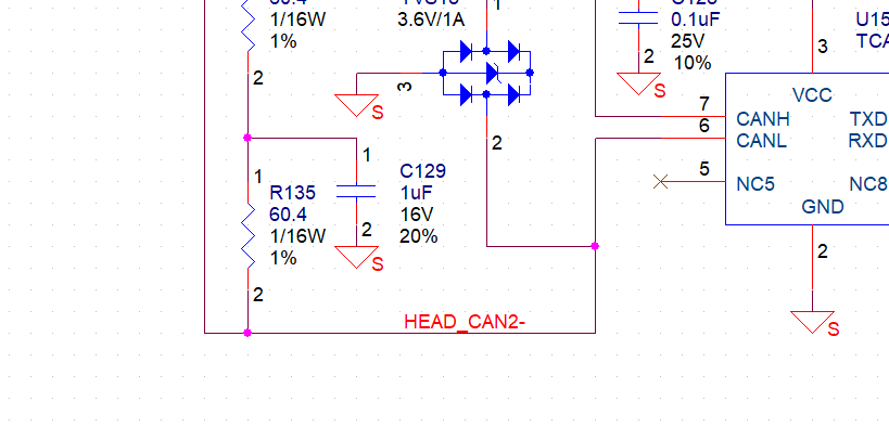

Working with 17.2 ver S079. Trying to find a net for the second line of a differential pair. Net is labeled on the schematic, net shows up on the parts placed on the board but net does not show up in the list under the constraints manager.
The net HEAD_CAN2- does not show up on the list.

    Maybe this nnet is in a hierachy bloc and the name is different outside of the block:; the net name  outside win

    Its probably part of an xnet in Constraint Manager, select Physical - Net - All Layers then choose Objects - Filter and turn on the Nets of Xnet
