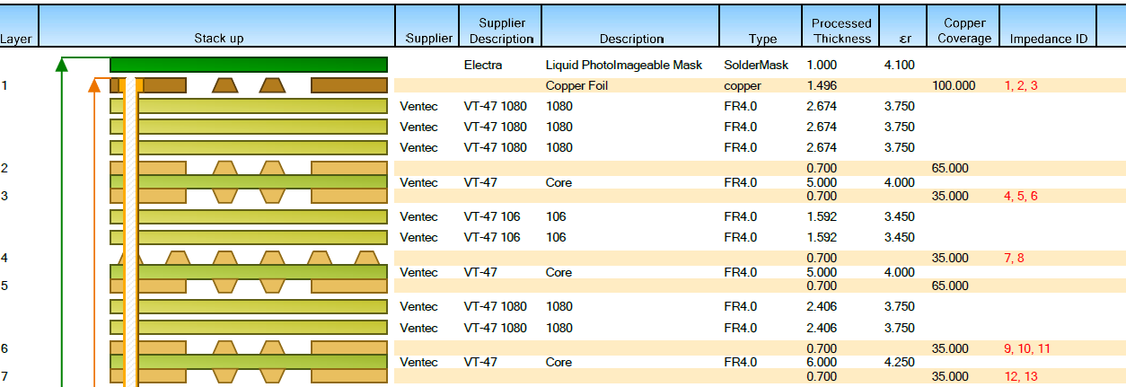

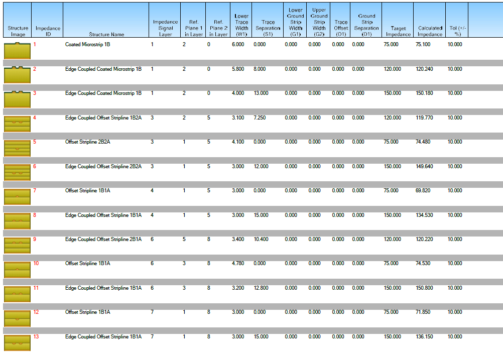

Hey,
We are routing 4 different impedances in one of our designs, that is 75, 150, 60 and 120.
As far as top layer concern, reference plane is second layer but PCB layer 3 and 4 are impedance control layers and their reference plane are 5th and 1st for specific impedance. PFA reference stack-up.
Please find impedance table,
How can I route signals on 3rd and 4th layer as impedance controlled ( 75 and 150 ohms signals are the major concern).

    Based on stackup information, the layer based impedance is auto calculated which i believe will auto set layer 3 and 4 to have 75 & 150ohms.
