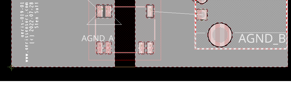

PCB Editor Allegro Copper Etch is Highlighted
Netsballer92
Netsballer92 over 4 years ago
I am not sure why all the layers have copper etch highlighted and also some pins.
  • steve
    steve over 4 years ago
    Probably because they have been selected / highlighted. Try Display - Dehighlight then in the Options pane on the right hand side click on All, if they don't change try unclicking "retain objects custome color" and see if that helps.
  • Daniel
    Daniel over 4 years ago
    Way 1: Try to select it and pick anywhere.
    Way 2: write to in alegro.inilit cove below,and then cmd: "at" to de-hilight all by skill
    axlCmdRegister( "at" `dehl_all ?cmdType "interactive")
    procedure( dehl_all()
    axlDehighlightObject('all t)
    axlVisibleUpdate(t)
    );end
