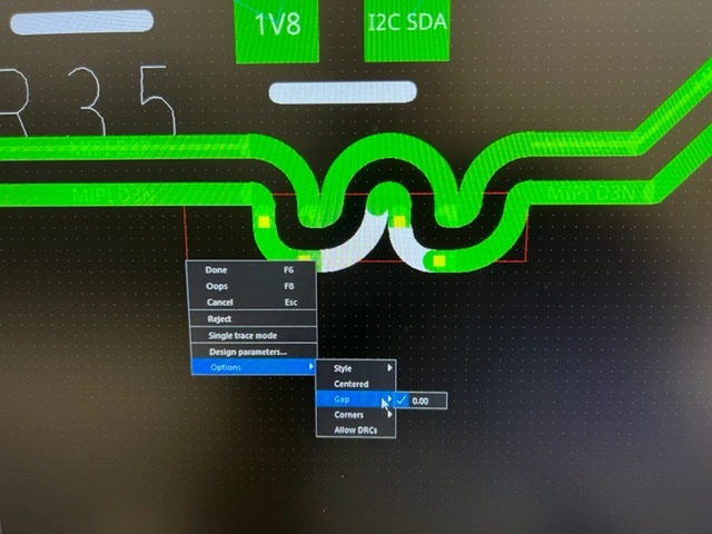

Differential Pair Accordion Delay Tuning Gap
Sagetech
Sagetech over 4 years ago
Trying to match some diff pairs in length. When I select delay tune and accordian mode, the resultant gap is zero and I can not set it. I thought by default the gap was set to 3x trace width. Can't find where to set this - pointing me in the right direction is appreciated.
Using 17.4 SO26

    DavidJHutchins over 4 years ago in reply to Sagetech +1 suggested
    try opening Setup>Design Parameters... then in the Route tab select the Delay Tune command, in which there is a 'reset' button... If that doesn't help then I think you might have a corrupted desig…

    once in the 'delay tune' command, select the Options tab & there is the Gap dropdown menu with '3x width' as the default value in 17.4 S031

    0 Sagetech over 4 years ago in reply to DavidJHutchins
    Agree, that is how it "should "work. My drop down give me the option of 0.00. If I try to change it the drop down closes.

    0 DavidJHutchins over 4 years ago in reply to Sagetech
    If that doesn't help then I think you might have a corrupted design Disappointed
