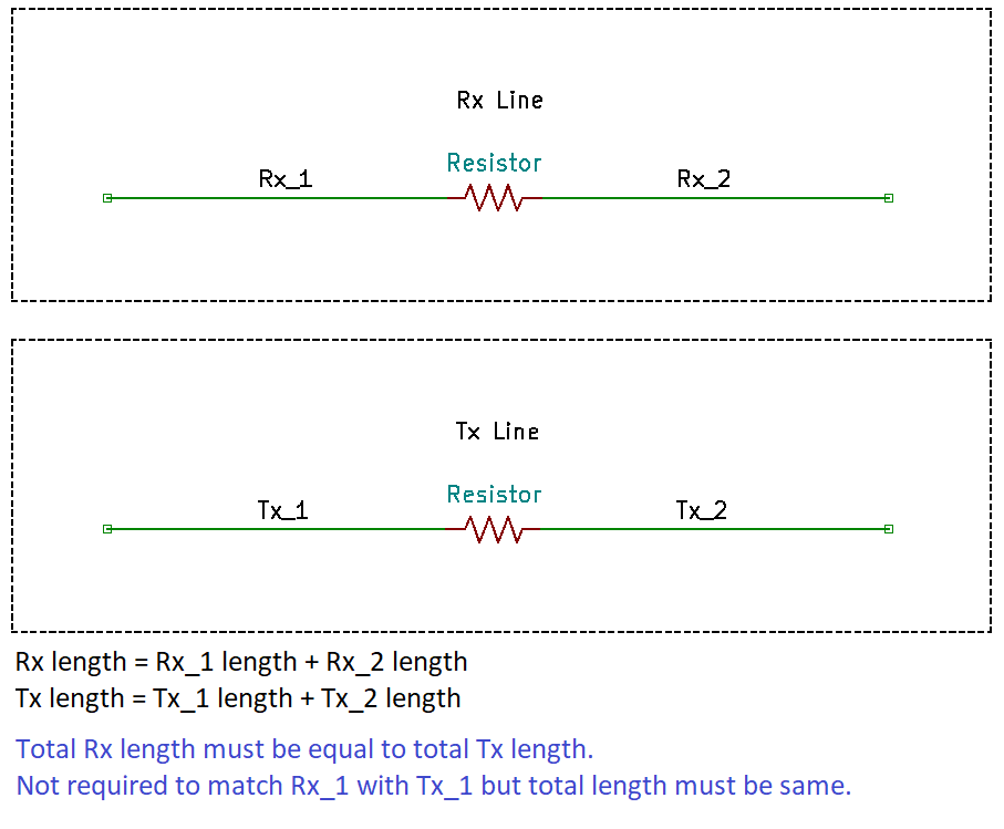

How to set up constraint for this kind of etch length matching. Currently, it is very difficult process as we calculate it individually and sum it to match the total length. If a board is having multiple this kind of nets and more number of components in series then the length matching consumes too much time. What is the best method to do this kind of length matching.

    Have a look to "xnets" in documentation: this for handle this case
