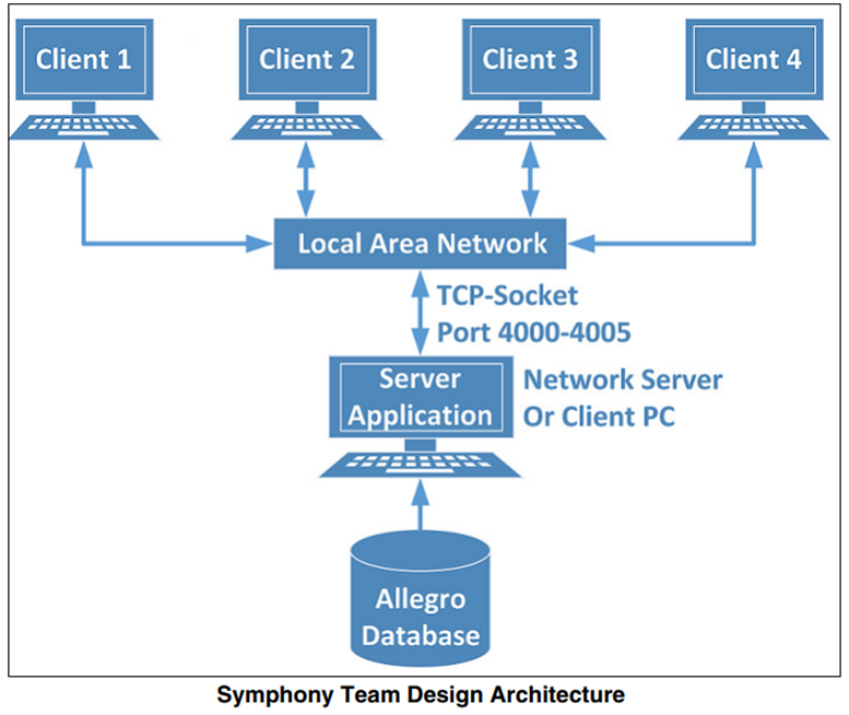

The architecture of this concurrent solution is summarized in the figure below. It shows a server process controlling a PCB board or a package file, and Layout Editor clients connecting to it using TCP-Sockets.
