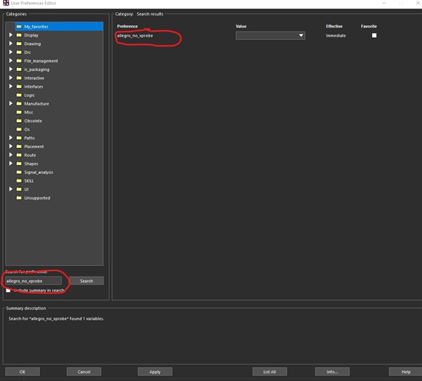

Hi All.
Cross probing is not working from board file to schematics. but its working properly in schematics to board file. I'm using OrCAD 22.1-2022-S004
Can somebody guide me to fix this problem?
Cheers
Jithindev

    Hello Jithin,
    Try resetting allegro.ini file which is in your C:\Users\AppData\Roaming\SPB_Data\pcbenv folder (delete allegro.ini file, open and close any board file, new allegro.ini file should appear in pcb env folder). Make sure you have a copy of .ini file before you reset the original one.
    Thank you.

    Hi VVRD,
    I appreciate your response, and I followed what you suggested. still, the problem persists.

    Hii Jithin,Can you check allegro_no_xprobe is enabled?

    Hi VVRD,
    allegro_no_xprobe  is not enabled.

    are you getting any error message when you're trying to cross probe from board to schematic?
