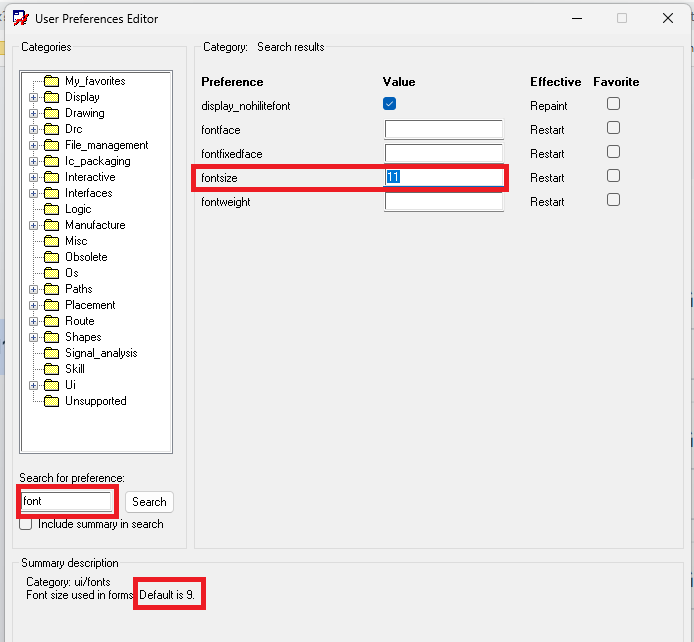

  • yu88
    yu88 over 3 years ago in reply to steve +2 verified
    lastly i solve this by adjusting fontsize in User Preference Editor

  • yu88
    +1 yu88 over 3 years ago in reply to steve

  • JuanCR
    0 JuanCR over 3 years ago in reply to yu88
    Hi yu88,
    ALLEGRO_HIGH_DPI_ENABLED is a Windows environment variable that is set to 1 in machines that use high resolution displays (4K dispalys). However, this mostly solve issues with forms that are clipped. Your issue seems to be more related to fontsize, like you mention in your following post. Did changing the font size solve the issue completely?
