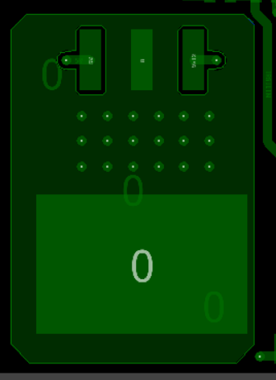

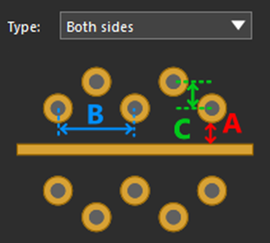

In Allegro, you can implement via stitching by using the Place > Via Array command and setting up the different parameters depending on the stitching you require:
