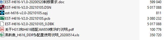

I got a reference design that is supposed to be made in OrCAD, but i cannot open the PCB file.
The files in my Zip looks like this, can anybody confirm that this looks like an OrCAD project?

    You can try to download one of the free viewers here and see if it can open it. I have this Pads Layout Viewer and it can open up Mentor Graphics Pads designs that are .pcb. Worth a try. https://eda…
  • Byron365
    0 Byron365 over 2 years ago
    The schematic definitely looks to be from Cadence. The board file looks like it might be Mentor Graphics Pads file as they use .pcb extension. Maybe there are others(?)

    I use Altium at work, and Altium has .pcb extensions but it wont open there.
    I downloaded a 30day trial of OrCAD to try to open the files, but had no luck.
    If anyone can open the .pcb file i would gladly send the design to try to convert it to something readable.
    It is a reference design for a minicomputer with the Allwinner H618/616 chipset, (like OrangePi)
    It has no secrets so if anyone want's it and can help me out converting it i would be glad.
    Both Orcad and Altium opens the Schematics without any problems, and due to the speed it opens in OrCAD i would guess it really is a OrCAD format of some kind....but my Trial cant open it.
    https://eda.sw.siemens.com/en-US/pcb/downloads-files/?cmpid=12938
  • Robert Finley
    0 Robert Finley over 2 years ago in reply to Byron365
    You will want PADS standard as Pads Professional is Expedition light.  Totally different animal.
