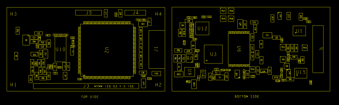

Greetings,
I receive a PCB package from a consultant and they created a single page with the assembly top and bottom on the same drawing. Each view is also scaled up to 3:1.
I would like to learn how to do this.
Thank you!
Best regards,
Fred
  • excellon1
    0 excellon1 over 1 year ago
    First step is turn on your Assembly top layer or any layer that contains the info you want to include in the scaled drawing.
    To create a drawing similar to the picture all you have to do is create a "Detail" of your assembly layers. Go to Manufacture > Drafting ,click on "Create Detail"
    In the options pane you can set the scaling factor and the class where the drawing will be, typically the classes are Manufacturing with a sub class of Details.

  • FH202409063758
    0 FH202409063758 over 1 year ago in reply to excellon1
    Took me a few passes to figure out how to do this. Thank you!
    It took too many tries to mirror the bottom view.
    Thank you again!
