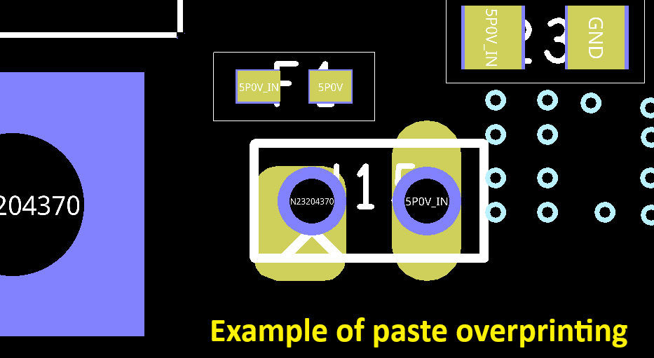

Intrusive reflow soldering is also known as "pin in paste". This is a soldering technology that enables the assembly of through-hole components without the need for hand soldering or wave soldering. If you are designing a product due for automated assembly in large batches, then it is worth considering this technology.
A key feature of "pin in paste" is that through-hole pins are soldered during the same production stage as the surface-mount components. This can be a significant saver for both production time and cost compared to solder-wave production or hand soldering.
Surface paste is deposited on and around the pin holes of the PCB. A large "overprint" of solder paste can be used, which will attract into the hole during the temperature cycle, which melts or “reflows” the paste. Oblong shapes or other unique paste patterns can be used to avoid contact with adjacent pins while ensuring that a sufficient volume of paste is provided to fill these holes.
