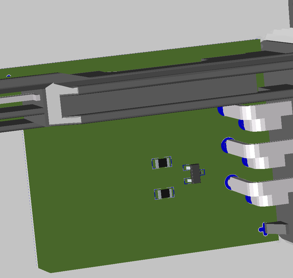

Dear All
in the 3D model I cannot see the traces
Could you help me?
  • Agente008
    Agente008 over 1 year ago in reply to AsbjornEdvalds +1 verified
    I have found the solution
  • AsbjornEdvalds
    0 AsbjornEdvalds over 1 year ago
    When opening the 3D Canvas, you must have the "clines" option chosen in the 3D Canvas filter window.
