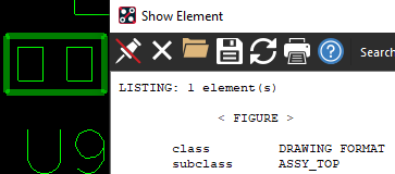

  • BK20241203831
    0 BK20241203831 over 1 year ago in reply to DavidJHutchins
    Thanks, David!
    Tried to use the script, but then I realized that when I export and then import plot file (IPF), all pads turn into a "Figure" as a DRAWING FORMAT. I am not able to find a way to fill "Figure" objects in Allegro.
    Do you know if there is a way to fill "Figures"? I can then modify the script for it.
  • DavidJHutchins
    0 DavidJHutchins over 1 year ago in reply to BK20241203831
    I modified the command to now allow the use to specify both the Class & Subcass, below is an example from the journal file:
    \i (00:03:00) fill_ipf 'Drawing Format' ipf_plot
    \t (00:03:01) Deleting 1013 figures
    \t (00:03:01) Converting 708 lines to filled shapes
    \e (00:04:21) ERROR(SPMHDB-187): SHAPE boundary may not cross itself.
    (00:04:21) *WARNING* (axlDBShape): Shape is not legal for Allegro, run dbdoctor
    (00:04:22) Loading apt.cxt
    (00:04:22) Loading apt_utils.cxt
    \i (00:04:22) generaledit
    the attached zip file contains the latest skill code
    https://community.cadence.com/cfs-file/__key/communityserver-discussions-components-files/28/fill_5F00_ipf.zip
