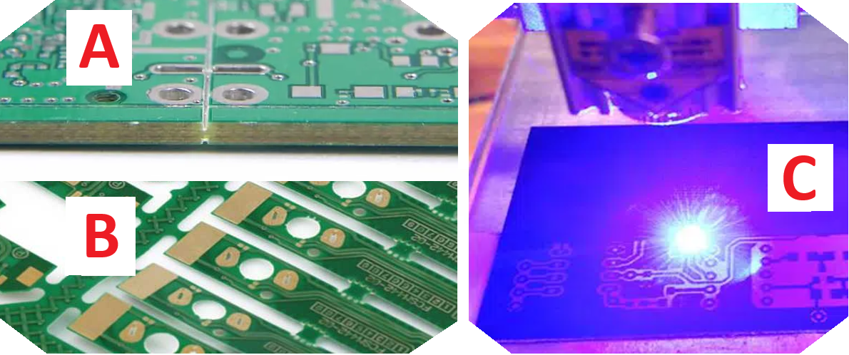

Test Your Know How: PCB Separation
PCBTech
PCBTech over 1 year ago
Organize these three separation technologies into order:
1. SPEED
2. COST
3. STRESS
A = Scoring, B = Tab Routing/Milling, C = Lazer Cutting
Which is the fastest speed, the highest cost, and the highest stress on the PCB and surrounding components?
If you are concerned about product lifespan in your designs, do you consider these factors? Simply answer your order in the comments below. Any further input or questions from your experiences are also very welcome!

    We typically use v-groove and a "pizza" cutter to separate. This requires components to be spaced away from the edge, we have seen components damaged if too close. For our high volume designs, (100K…

    We use all these methods. They all have their own advantages and disadvantages. Most often we use Mouse bites and v-scores on the same design. Laser singulation is great for rigid-flex or very small…

    John T over 1 year ago
    In reply to this we would like to publish our results:
       1. Speed => A. Scoring
       2. Cost => C. Lazer Cutting
       3. Stress => A. Scoring
    Scored PCBs are separated using dual "pizza slicer" blades. This action happens very quickly in one swift linear motion. These cuts are generally not selective and cannot reach some areas of the pcb. Complex pcb shapes must have some pre-routing performed on the pcb during fabrication. The final cut following component assembly, happens on the contact areas that remain between adjacent pcbs. These pcb borders must be partially pre-cut into thin v-groove using similar "pizza blades". This makes the final pcb separation very fast and the cut line is a little bit rough on the pcb edges
    Lazer cutting is considered an expensive process and is not considered to be fast. Cutting by lazer typically requires many multiple passes over the same cutting line. Each pass removes a thin layer of material in a process known as ablation. There is some risk of conductive carbonised residue on the pcb edges from this. As a result of machine cost, this is generally considered to be the more expensive solution in the current market. It is more typically found in assembly processes that involve thin pcbs such as flex designs.
    Scoring wins ( or loses) again for component stress. In many industries component stress during separation is considered critical. The highest risk components for stress are typically ceramic capacitors which can crack during pcb separation. However, long resistor bodies, such as 1206/1210 or similar, can also crack under such mechanical stress. If mechanically sensitive components are located close to the cutting border ( <5mm or so) then it is advised to pre-route the board in these locations to reduce the stress applied by the scoring blades.
    Note that separation by milling is also considered stressful. However, typically milling tabs are placed in specific locations evenly around the pcb which reduces the total stress impact on the board.
    If you have any other experiences, comments or observations ( or even disagreements) on the points listed above,  then we would be very happy to read and reply to any comments in the section below. Looking forward to hearing any reactions!
