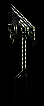

hello
coping an object like clines and pasting the mirrored object are fine.
       original                      mirrored copy

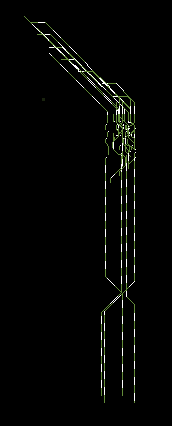

However, moving mirrored clines does not work.
        original                      mirrored move
Is there a way to move mirrored objects?
regards
masa

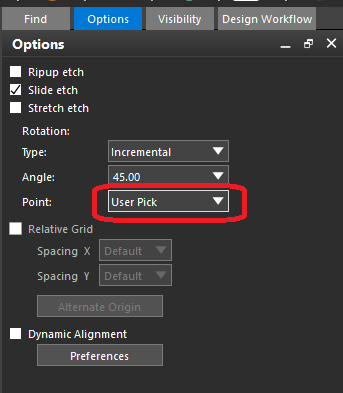

  • andakConsultingLtd
    andakConsultingLtd over 1 year ago +1 verified
    Moving mirrored clines should work without problems. I think your issue is not due to the mirrored traces but due to something else (maybe they are part of a group, fixed objects, marked as fanout etc…
    +1 andakConsultingLtd over 1 year ago
    Moving mirrored clines should work without problems. I think your issue is not due to the mirrored traces but due to something else (maybe they are part of a group, fixed objects, marked as fanout etc)
    Anyway, assuming you're using old GUI, try moving with this option enabled.
  • masamasa
    0 masamasa over 1 year ago in reply to andakConsultingLtd
    thank u for ur response.
    it works,
    regards
