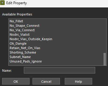

hello
is there a way to retain a net with a floating via?
this via is not connected to any net so i assign a net to the via and fix the via.
but after i connect a cline with the via and delete the cline, the net on the via disappears although the via is fixed.
regards

    0 masamasa over 1 year ago in reply to excellon1
    thank u for ur response, excellon1.
    i am using 23.1 and actually i found the solution.
    using "retain_net_on_via" on the via property solved my problem.
    regards
    masa

    Hi Masa,
    Yes indeed, that will work, however on 17.2 there is no need to actually invoke that property after assigning a net to the via. It is unusual that without the propriety your via disappears. But hey you got it working so that's good.
    Usually on vias that have a net what I typically do is simply copy the via, but in the Options panel there is the option to retain that net or not.
    Typically I have the retain net check box ticked.
