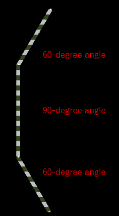

hello
i am turning the route offset on and off to get this for different angled clines.
is there a way to set the line lock to 30 degrees so that i can do this in one stroke instead of 3 strokes?
currently only 45 and 90 degrees are available.
regards
masa

    hi masamasa
    1, set the route offset to 60 degree as default value on the design parameter ;
    2, set hotkey as below ,you can use F2 to swich line mode of 45/60 degree very easy.
    alias a1 'FORM mini routeoffset_on YES;FORM mini lock_direction 45'
    alias a2 'FORM mini routeoffset_on NO;FORM mini lock_direction 45'
    alias a3 'FORM mini lock_mode Line;FORM mini lock_direction 45'
    alias F2 'settoggle CMD a1 a2 a3 ;$CMD'

    thank u xiaome8.
    it works.
    regards
