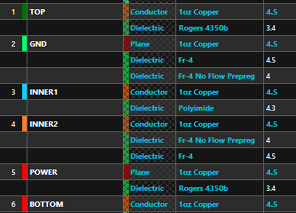

Real-World Example: 6-Layer Hybrid Stackup
Here’s a simplified example of a hybrid stackup for a mixed-signal board:
This setup keeps the high-speed and RF signals on low-loss layers while using FR-4 for the rest to keep costs down.

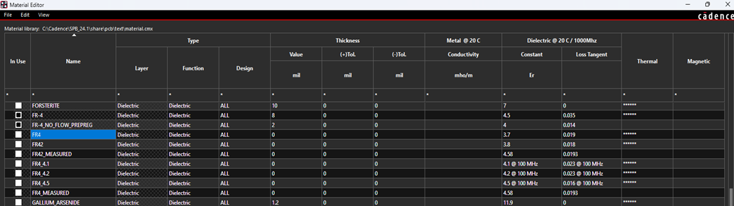

To accurately model such a stackup, especially when combining materials with different electrical properties, tools like the Cadence Allegro Cross Section Editor can be quite useful. It enables designers to choose from a library of predefined dielectric materials or input custom ones by specifying parameters such as Dielectric constant (Dk), Loss tangent (Df), Conductivity, Density, and Specific heat. If the required material isn’t available in the default list, you can define it through Setup > Materials > Material Editor and incorporate it into your stackup.
This ensures that impedance calculations are based on realistic material behavior, which is critical for maintaining signal integrity in high-speed and RF designs.
