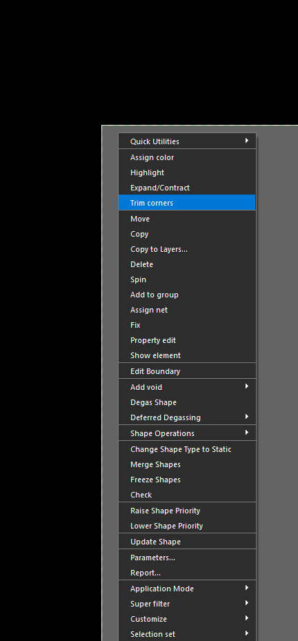

hello:
on a rectangular shape, is there a way to trim one corner instead of trimming all 4 corners?
regards
masa

    Have a look at the Shape Edit Application Mode. Once enabled there are options to set the Trim, you can then hover over the corner of the shape, the icon will change and you can then left click to convert…

    hello steve: thank u for ur reply. unfortunately, i have no menu for "convert the corner" but only "trim corners" and if i click the trim corners, all 4 corners get trimmed. do u know…

    As I said for a single corner simply hover over it, the icon changes then left click it, you only need to right click if you want to do more than one.

    hello steve:
    do u know the command for converting one corner?
    regards
    masa

    thank u for ur response, steve.
    i do not get the icon changed.
    i do not use an icon to start with.
    what kind of icon r u talking about?
    regards
    masa

    Sorry not an icon but the mouse pointer, it changes to a smaller cross. If you go to YouTube and look for parsyseda channel then search for Cadence PCB Shape Edit Application Mode the video covers all options, trim corners is 2.46.
