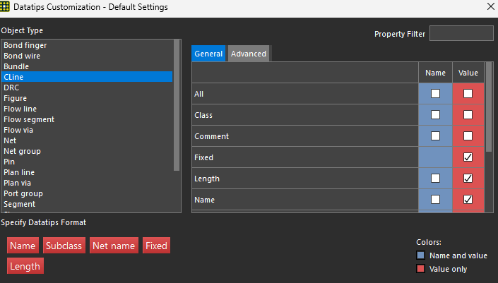

hello
is there a way to show the length of a particular net as the datatip information?
i checked the length value on the datatip customization setting but it shows only the cline length on the current layer.
on the datatip info, i would like to see the total length of a particular net accumulated thru all layers.
regards
masa

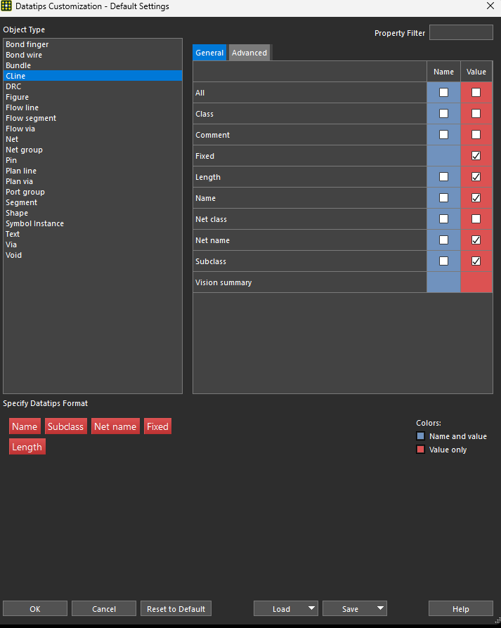

  • steve
    steve over 1 year ago in reply to masamasa +1 verified
    Hi Masa - Look in the list on the left hand side. Net is 6 lines below Cline....

    Yes try the Net Object Type
  • masamasa
    0 masamasa over 1 year ago in reply to steve
    thank u for ur response, steve.
    unfortunately i do not see net object type on my datatip customization setting.
    regards
    masa
  • steve
    +1 steve over 1 year ago in reply to masamasa
  • masamasa
    unfortunately the net item does not work either.
    regards
    masa

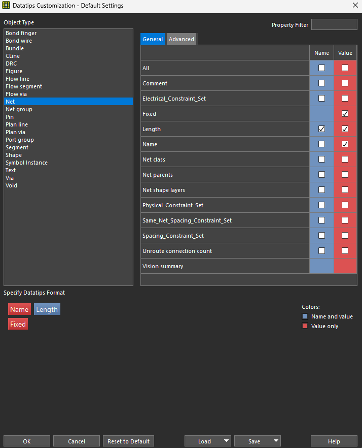

  • excellon1
    +1 excellon1 over 1 year ago in reply to DavidJHutchins
    Hi Masa,
    It is possible to determine the net length by using a data tip, However it only works if the Net is routed. If the net is UN-routed then
    the net length will be zero.
    In the Data Tip for net,  check the following.
    NET - Length, Name & Value "Check both boxes"
    NET - Unroute Connection Count, Name & Value "Check both boxes"
    Click Ok to save that Data Tip.
    In your find filter choose "Net" Hover over a cline that is routed. The data tip should display the net length. I checked this in 16x, 17x
    of Orcad / Allegro. Looks to work fine here
    Best Regards.
  • masamasa
    0 masamasa over 1 year ago in reply to excellon1
    thank u everyone.
    it works after i filter only nets.
    regards
    masa
