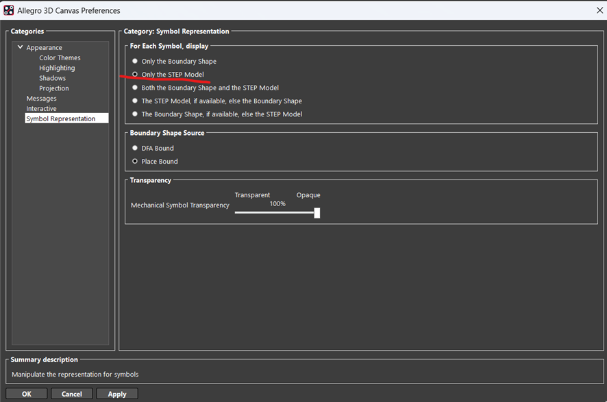

I tried to set the ".step" file into the ".dra" file I created, but the 3D mapper button does not appear.
I already checked this on the preference page.
However, the button does not exist on the window. It does not exist on the View>Windows.

    Hi KAnalog , Please check in View > Windows and enable the 3D Mapper tab if not enabled.

    Hi mahimag , Thank you for your comment. I already tried it, but there was no tab in View > Windows. (I wanted to add screen capture here, but I couldn't due to error.)

    Can you check your hotfix version by going to Help > About in tool? 3D Mapper is introduced in later hotfixes for 17.4

    My version is "17.4-2019 S008". Is it not supported in this version? In that case, is there a way to add a .step file?

    Yes, you will not have 3D Mapper in hotfix 8. You can use Setup > Step Package Mapping dialog box.

    Thank you so much. I was able to successfully set up the STP file. I deeply appreciate your assistance.
