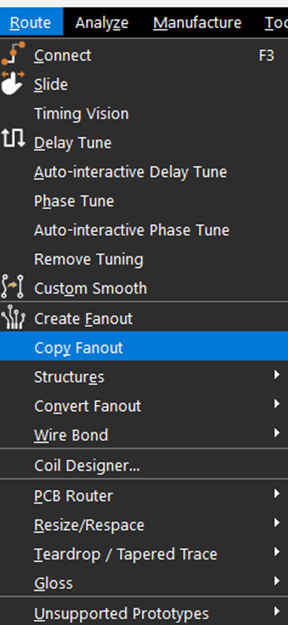

Now, here's the magic trick: duplicate fanouts across similar components in just a few clicks. Imagine creating one fanout for a relay and replicating it across 75 relays in seconds. It's that easy - just use Route > Copy Fanout and select the component with the desired fanout.

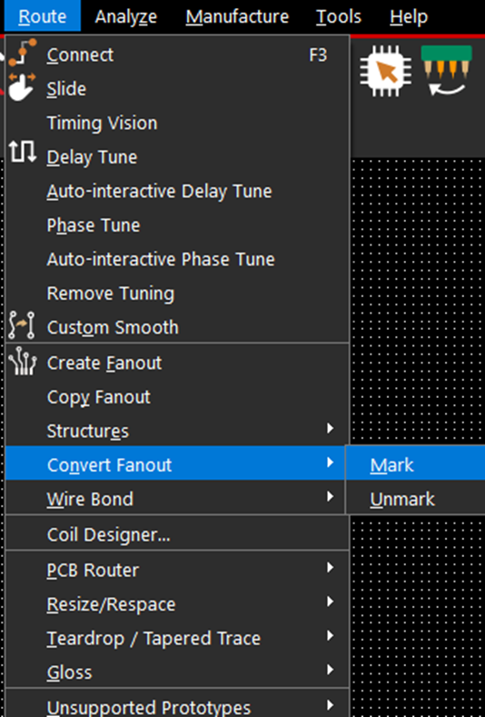

Struggling with manual fanouts? Try the Mark option to bind your fanouts to the symbol, making it seamless to move them around. Follow these three easy steps to get started:
 Supercharge Your Workflow in 3 Steps:
  1. Head to Route > Convert Fanout > Mark
  2. Enable clines and vias in the Find tab
  3. Select the cline segment and vias to mark them along with the symbol
Unlock the benefits: move the symbol and the marked fanout follows, saving you time and reducing errors.
Want to break the association? Simply use the Unmark option and reverse the operation.
