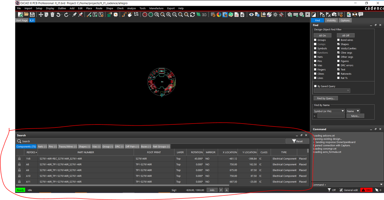

After updating to 25.1 in Allegro, the search view always remains open after restart no matter how many time i close it. It always after a restart reappear again.
OrCad also in startup get stuck on "Initializing MPS" for 1-2 minute

    0 Ben Bina over 1 year ago in reply to Jeet
    Here you go. Thanks in advance

    0 Jeet over 1 year ago in reply to Ben Bina
    After performing Display > UI Settings > Reset UI to Default, search window gets closed or is it still open ?
    still open. reset ui did not helped

    0 Jeet 11 months ago in reply to Ben Bina
    You will be contacted by separate channel of communication in order to look into your issue regarding unable to close Search Window in Allegro PCB Editor Version 25.1
