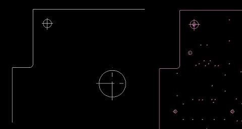

     Here's the result I get.
    Note: the two features were added as lines on a different layer.  The right side has the drill figures and lines.

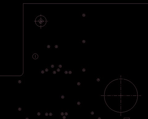

    Here's a close up of the brd with lines and drill figures on.

    Well Tried this on a second board, and it worked.  Something must be particularly wrong on the first board.  I'll need to dig into it.  I did not create these, but just fixing them Disappointed.

  • excellon1
    0 excellon1 over 1 year ago in reply to Wildwpe
    Sure thing wild.
    I did some more checking. So Zcopy does not work on details. Console reports "Not a closed polygon or Cline, element ignored"
    I seem to recall seeing something similar  to this years ago.
    Anyway creating a regular detail either expanded or contracted works good. Creating a detail on a custom added sub class "Details2"
    works good too. Extra class was added to Manufacturing. I used drills like in your picture.
    ECO Fun eh :)

  • Wildwpe
    0 Wildwpe over 1 year ago in reply to excellon1
    Well I finally had a chance to dig into this issue some more here's what I found:
    The detail breakout will copy from the Ncledgend-x-x, but not from the Ncdrill_Figure.
    So above I was mistaken:
    On the second board I had on both the Ncledgend-x-x and the NCdrill_Figure, I had missed that I had this on.
    So, I consider this closed unless my observation is incorrect.
