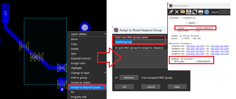

Sometimes we may need to allow a specific net, such as ground, inside a route keepout. No other nets should be allowed.
How do we achieve?
One answer is assigning the Route Keepout shape to an RKO Group.
Do this using the right mouse button over a route keepout shape, and choose “Assign To Keepout Group”.
Now enter a new group name.
This group membership is now seen displaying a show element report of the keepout.

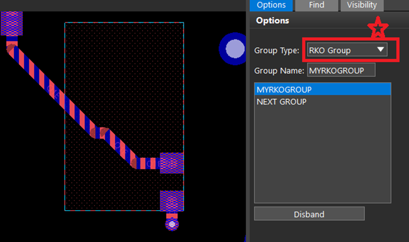

To add the nets to this RKO Group:
  • Choose the menu Edit > Groups.
Alternatively, type “groupedit” in the Command window.
  • Select the group type from the dropdown: “RKO Group”.
  • In the Options panel, choose the group name you want to add objects to.
  • In the PCB Canvas, now select the nets you want to add to the group.
  • Choose Done from the pop-up menu.
DRCs will now be eliminated for elements that are part of this group.

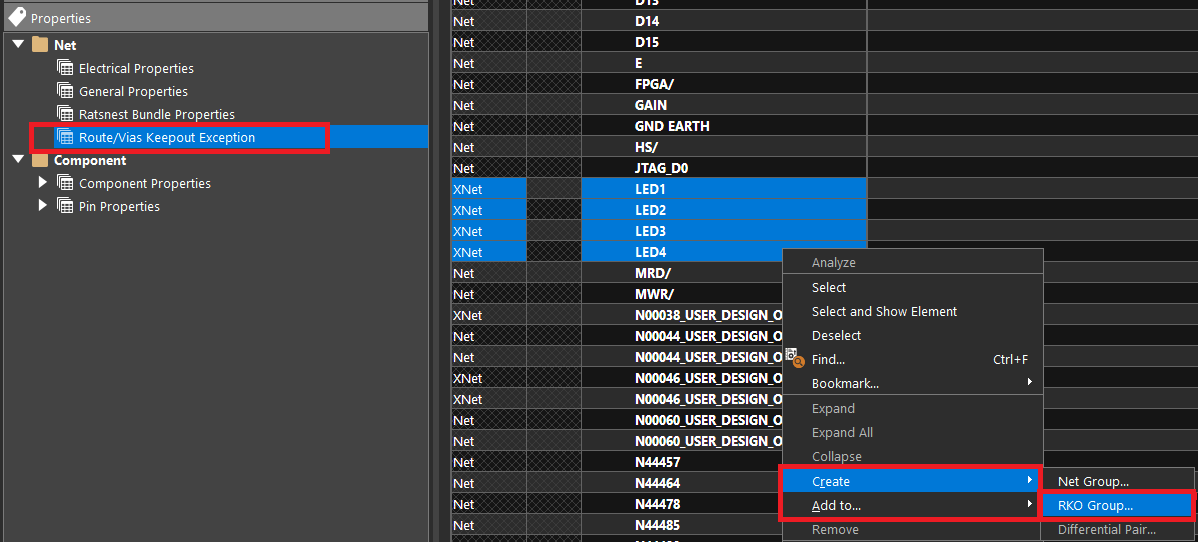

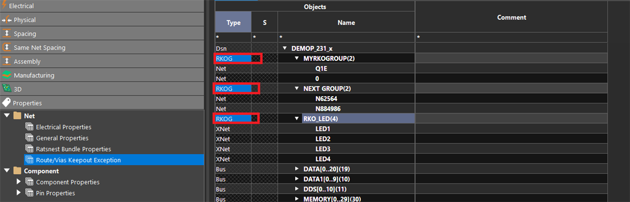

    Thanks Excellon1, your are 100% correct. Another method to do this is to:
    1. Go to Constraint Manager > Properties domain to expand the Net folder.
    2. Select a group of nets, XNets, net groups, or differential pairs in the Route/Vias Keepout Exception worksheet.
    3. Right-click and choose Create – RKO Group from the pop-up menu..
    4. Enter a name for the RKO group, or accept the default.
    5. Click OK.
    See snapshot example below.
    Alternatively the Add command can be used. The same member can exist in both the new and existing RKO groups
    Is this what you meant?
  • John T
    John T 11 months ago in reply to John T

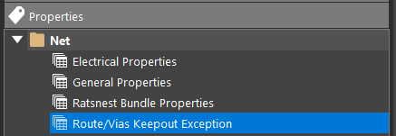

    It is in this net folder in the Constraint Manager that I can review the memberships list of nets for these groups - as shown by example here:
    Let me know if this makes sense?

    Hi John, Not exactly.
    You have to assign the "RKO to the shape in the pcb editor first" & then in the CM add nets to the group you wish to exclude from the RKO.
    SO in the pcb editor create a static shape on the Route Keepout layer you need , example RKO Top. In the options pane give the RKO a name
    in the "Assign to Keepout Group" BOX. Lastly draw the shape. (I used RKO_ALLOWED-NETS) as the group name name.
    Open the cm. Under the properties tab click on Route/Vias Keepout Exception. In the right hand pane click on the RKO Group Object so it highlights. In my case I would highlight RKO_ALLOWED-NETS
    Lastly right click on it and choose. Create > RKO Group Members. In the box select the nets you want to allow pass through the RKO.
    Best regards.

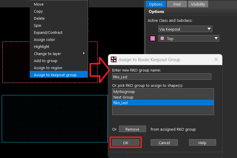

    I have now retested this on a  fresh design but I can confirm that it is not necessary to create the shape first.
    In Constraint Manger(CM), in the Net folder > Route/Vis Keepout Exception ( shown below.) We can create an RKO_Group for any net, bus, netgroup, etc... and later we can assign add Keepout shapes to this group.
    Please see below image showing that we can add either a Via Keepout or a Route Keepout to an RKO_Group that as already been created via CM. Use the right mouse button in the Editor over the shape to assign an RKO_Group name to any new keepout:

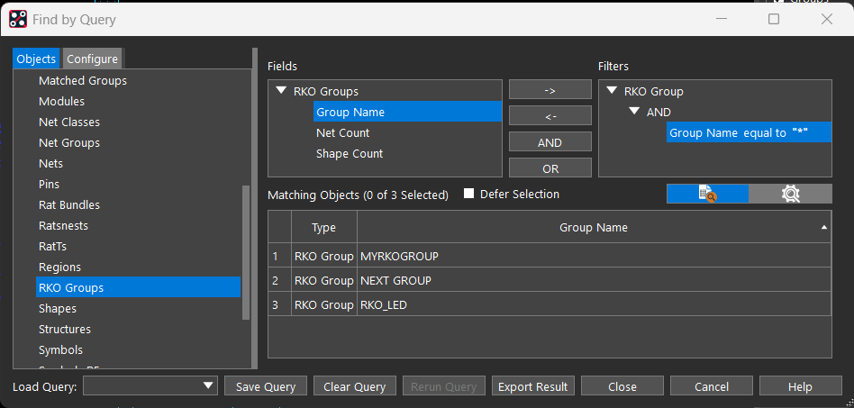

    As additional fyi - it is also possible to select and report these RKO_Groups using the find by Query ui as shown.
    Let me know if this works at your end as described?!
