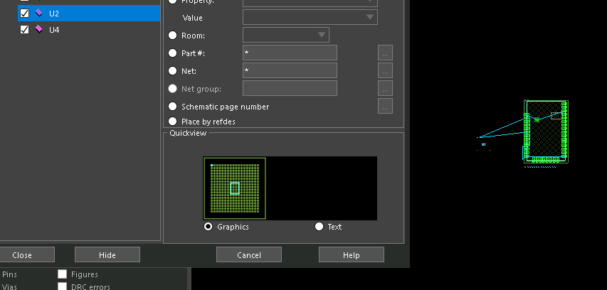

I'm working with a custom defined ball grid array (BGA).  I have created the PCB footprint with Presto, a grid of 18 x 18 pads.  Then I created the schematic symbol, and specified pins using the spreadsheet option.  Pins are labeled as A1, A2...D1,D2, etc. When I attempt to place the PCB footprint, I can see that the nets exist.  When I try to actually place it on the PCB and compete the operation, I get an error message that says: "(SPMHGE-82): Pin numbers do not match between symbol and component. Run dev_check on device file for more information."
In the screenshot example I have to two pins wired to the BGA.
Any insight would be great, thank you.

    Hi ML202512236951
    From the picture I see you are using PCB Editor layout tool although the FP is created with Presto.
    To solve the problem in PCB Editor, associate the correct device file to the symbol as follows:
    1. Open the .brd file and select Logic > Part Logic.
    2. Enter the refdes of the connector in the Refdes Filter column.
    3. Select the line immediately below the Refdes Filter column. This shows the Device file, Package symbol, refdes, and so on.
    4. Once selected, the Part Modification Area gets populated.
    5. Click the Delete button to delete the symbol. (See image below)
    6. Click OK to exit the PartList window.
    7. In the Logic > Part Logic window, click the Add button.
    8. Click OK in the message box that appears.
    9. Enter the refdes in the Refdes field in the Part Modification Area section.
    10. Click the Physical Devices button and select the correct device file from the Library Browser window.
    11. The fields in the Part Modification Area section get populated.
    12. Click Add and then Ok to exit.

    0 avant 10 months ago
    Every defined (electrical) pin on the footprint must have a corresponding pin on the schematic symbol, and vice-versa.
    The pin numbers must match between the two.
    The footprint can have mechanical pins (no pin number) without the need for correspondng pins on the schematic symbol.
