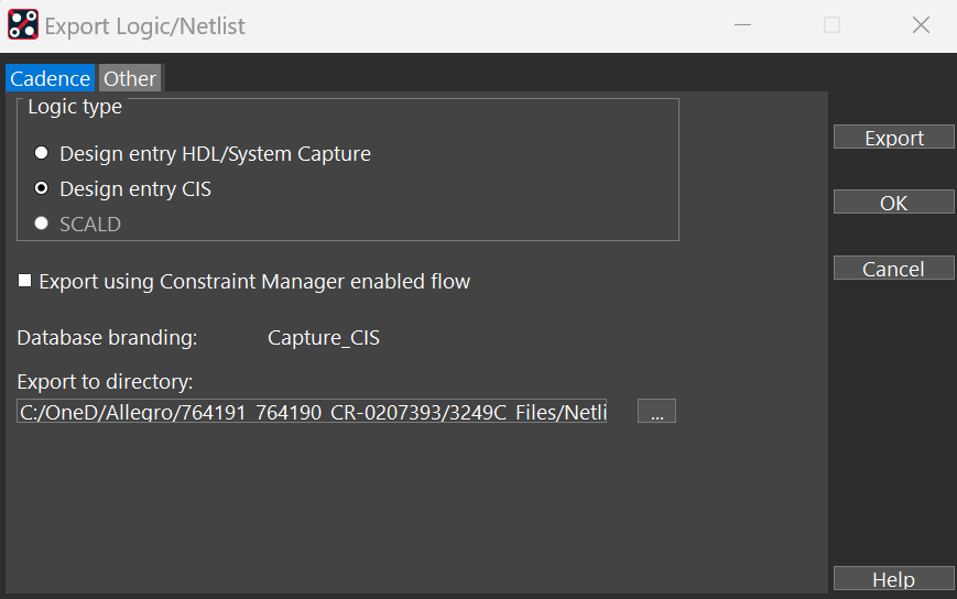

Had a really fun task I've been working and I am at the last step.
We had Gerbers from over 20 yrs ago and of course no board or schematic file, so I had to recreate the layout from the Gerber files.  I used DXF imports and the logic commands and have finished the work.  We did output artwork compares using a Gerber tool to confirm accuracies.
So here's my question:
I created 6 nets that have no logic assigned to them, and I can't seem to delete them form the database.  I am able to rename them, and confirm they are unassigned. Tried every trick I could think of.  Any suggestions? (please no skill code).
Thanks,
Wild

    How do you export a 3rd party netlist from allegro?
    I have tried all the variations I could find, and when I import the netlist I get an error:
    #1 ERROR(24) File not found
         Packager files not found
    #2   ERROR(102) Run stopped because errors were detected
    So I am at a loss....  TY
    Wild

  • JCTEYSSIER0
    0 JCTEYSSIER0 9 months ago in reply to Wildwpe
    Be aware "space" in directories and files . Sometimes it because they may be interpreted as field separator.
    I never use space ( ) but use underscore (_) instead
