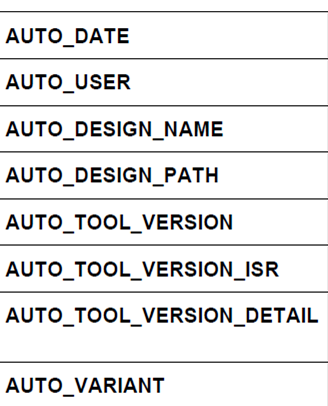

Dear all,
in system capture schema we have variables such as CON_TOTAL_PAGES and TOTAL_DESIGN_SHEETS for page title. May i ask if the variables with the same function also available in allegro x pcb editor(Allegro X Designer25.1) which can be used directly for page border? If not may i ask how could be possible define such a variables

    Hi MZ20250602835 ,
    In Allegro X PCB Editor, this can be handled using the Documentation Editor (part of the Productivity Toolbox) under Manufacture > Documentation Editor. Using the Wizard in the Documentation Editor, you should be able to achieve the required output.
    Incase If you don’t currently have entitlement to the Productivity Toolbox, please note that this request has already been logged as an enhancement to Cadence, to consider making this capability available as a standard feature in future releases.
