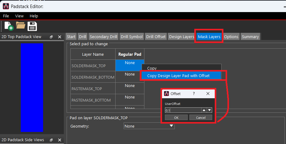

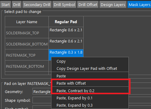

    Just fyi that Allegro X already introduced a subtle feature to help with paste and soldermask pad creation. I think it's really useful but there was not much fuss made of it. Just use the right mouse…

    excellon1 7 months ago in reply to John T +1
    Hi John, That looks to be a nice addition to the Padstack Editor, kind of similar to shape expansion, contraction in the PCB editor, cool stuff ! I echo your thinking on adjusting the land pattern in that…
