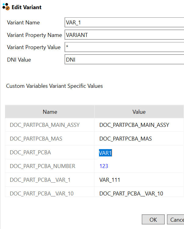

Dear All,
i used custom variables variant specific values for the base and variant assemblies.

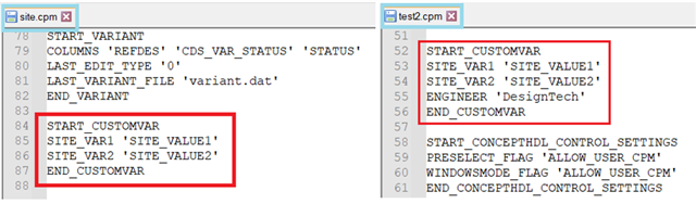

I tried to define DOC_PART_PCBA as Custom Variable in PCB-Editor in order to get the values, but it doesn't work. After extra i realized these values for variants are saved as below:
FILE_TYPE=EXPANDEDPARTLIST;
{ Variant Editor run on 08:32:10 Thursday, March 19, 2026 }
DIRECTIVES
PST_VERSION='PST_HDL_CENTRIC_VERSION_0';
ROOT_DRAWING='TEMPLATE';
POST_TIME='08:32:10 Thursday, March 19, 2026';
SOURCE_TOOL='PACKAGER_XL';
VAR_0_VAR_2 = '' ;
VAR_DEF_VAR_2 = '' ;
CV_VAR_2 = 'DOC_PART_PCBA=VAR2|DOC_PART_PCBA_NUMBER=456' ;
VDES_VAR_2 = '*' ;
VDNI_VAR_2 = 'DNI' ;
VPROP_VAR_2 = 'VARIANT' ;
VAR_0_VAR_1 = '' ;
VAR_DEF_VAR_1 = '' ;
CV_VAR_1 = 'DOC_PART_PCBA=VAR1|DOC_PART_PCBA_NUMBER=123|DOC_PART_PCB_NUMBER=123' ;
VDES_VAR_1 = '*' ;
VDNI_VAR_1 = 'DNI' ;
VPROP_VAR_1 = 'VARIANT' ;
ALTERNATE_VALUE = '99' ;
END_DIRECTIVES;

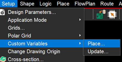

May i ask how could i get these values also in pcb editor for page board?  I already set TBX_CUSTOMVAR_SOURCE_CPM = TRUE. Many thanks.
Best Regards
Moyan

    many thanks for your reply. If i understand correctly what you mean is regard to this How can I transfer user-defined property from System Capture to Allegro?
    I defined the custom variables within cpm file. If you use custom variables variant specific values in system capture schema and these values aren't saved with in cpm file.
    So i would like to ask how can i assign these values also to custom Variable in pcb editor.

    May I ask what would be the role of these variables in PCB editor?
  • MZ20250602835
    0 MZ20250602835 7 months ago in reply to Elecguy
    Dear Elecguy,
    you can transfer the metadata info such as part number to pcb by customer variable.
