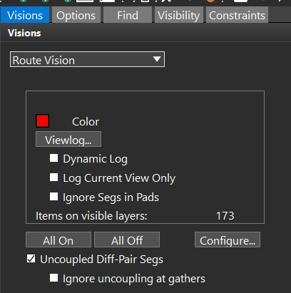

I am analyzing highspeed differential pair traces in my design and would like to identify the portions of the differential pairs where they become uncoupled.
I understand that there is an Electrical Constraint Check available for uncoupled length. However, in my case, the constraints are frozen and uncoupled length is not defined. Is there another way to easily identify or verify uncoupled regions in the design without modifying the existing constraints?

    Hi BC202603263145 , The Route Vision under View > Vision Manager should help you in this case. Please check the same. Once this is set, the uncoupled portion of DPr will be highlighted in RED color…
