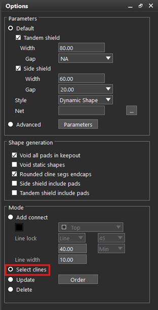

Shield Routing in Allegro X PCB Editor lets you add copper shields and keepouts that follow your signal routes and stay linked for future updates. It’s especially useful for noise sensitive and highspeed designs.
Best Way to Use It with Differential Pairs:
  1. Route the differential pair first
  2. Go to Route > Shield Router.
  3. Set Mode = Select clines.
  4. Set your shield parameters (side/tandem, width, gap) in the Parameters section.

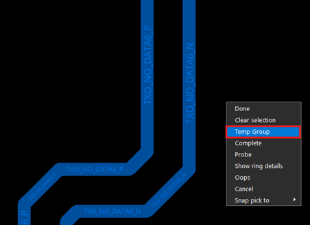

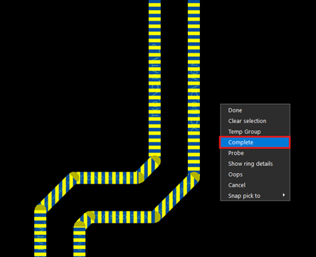

In the canvas:
1. RMB > Temp Group
2. Select both diff‑pair nets
3. RMB > Done
4. One consistent shield is created for both nets.

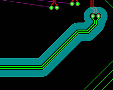

Why Use Shield Routing?
  • No manual copper shapes
  • Shields update automatically when routes change
  • Supports side shields, tandem shields, and via fences
  • Ideal for DDR, SERDES, USB, PCIe, and RF signals

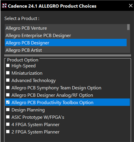

  • JCTEYSSIER0
    JCTEYSSIER0 7 months ago
    from which tool version this feature exist? And which licence level?
    24.1s008 / Allegro PCB Designer here and i do not see this menu
  • Gowtham P
    Gowtham P 7 months ago in reply to JCTEYSSIER0
    This utility comes as a part of Allegro/OrCAD Productivity Toolbox Option.
    Please check with your supplier for the same.
