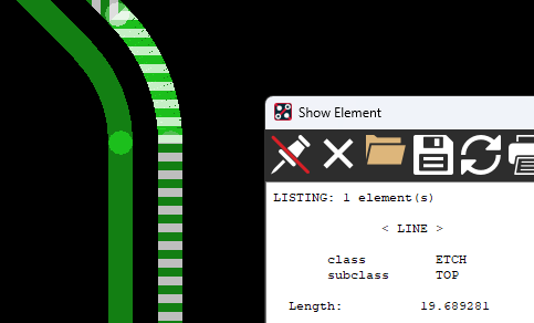

I imported trace geometry from HFSS to Allegro using IPC2581. After import, when I move the differential pair traces to the Top etch layer, the traces do not get any net name even when placed over pins.
When I query the geometry, the traces are showing as Line objects. But in my other designs, traces are Cline objects.
How can I convert these Line objects into Cline objects?
I would prefer not to manually reroute the traces, as it takes more time and effort.

    Tools / Derive Connectivity. The line enpoint must be snapped to a pin or via.
  • avant
    +1 avant 5 months ago

    Thanks! avant
    Tools>Derive connectivity helped
