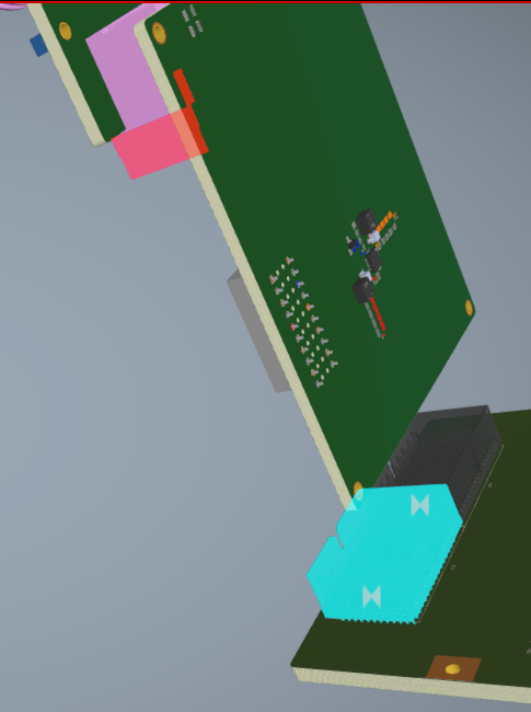

A critical feature missing from 3Dx is collision detection. The new 3D drc is good for internal designs, but I can't determine if mechanical imported models collide with the design. This is how I check multi-board assemblies, by exporting each board to a STEP then importing them into one canvas to assemble and check for collisions. Also, 3Dx doesn't allow me to select faces on component bodies (like a connector) to snap with XY like on the old 3D canvas...this makes assembly impossible besides doing it by hand!
I can't use the old 3D canvas since it has recently become unstable when importing 3D models, so forced to use new 3Dx that is missing core features.

    Both are available in the new 3dx canvas. Cadence have added a 3D Constraint Manager section where you can set values for parts to checked and the clearance required so check that out. For mapping inside a board look at the View - Model mapper pane which will allow you to add models and choose faces as you did before (AUTO, MAN, TOP, BTM, XY, Z and values). If you need to do this for a PCB Footprint look at the 3d Properties pane to choose step models, the same mapping capabilities are also available (AUTO, MAN, TOP, BTM, XY, Z and values).

    Thanks Steve, got the collision constraints working. Nice that it can be automated, but way harder to maintain and tell exactly where the collision is happening compared to the old tool.
    Still having an issue where I can't select a face on the mechanical step model (the red face on the top board) and then XY mate it to a face on the inside of a connector on the main board (the actual brd file that launched the canvas). This used to work in the old tool, I used it to put a 2280 M.2 SSD into a socket that was a component on the main board.

    There are now DRC markers in the 3dx canvas that show where the clashes are so make sure they are turned on. For the face mapping, I managed to reproduce this and passed this onto the Cadence R & D team for them to hopefully fix at some stage.
