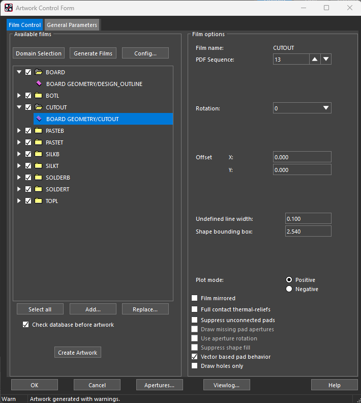

Hi everyone,
I'm facing a problem after exporting my Gerber files. My PCB outline and cutouts are not showing up for the manufacturer.
I'm using JLCPCB, and when I use their DFM tool to perform the final verification, everything appears correctly except the board outline and cutouts.
The board outline was created in Board Geometry > Design_Outline, and the cutouts were created in Board Geometry > Cutout. Both layers are included in my artwork and are being exported to the Gerber files that I send to the manufacturer.
Am I missing something? This is my first project using Cadence PCB software.

    Hi!
    1. Open Export > Artwork.
    2. In the Artwork Control Form, look at your Outline film.
    3. Expand the film (click the + next to the film name) and verify that BOARD GEOMETRY / DESIGN_OUTLINE and BOARD GEOMETRY / CUTOUT are actually listed there.
    4. If they are missing, right-click the film name, select Add, and pick those layers from the class/subclass list.
    5. Ensure the Undefined line width in the Artwork Control Form is set to a small positive value (e.g., 0.1) to ensure zero-width lines are rendered.
    Please post a screenshot of how your Export > Artwork form looks like.

    Hi Juan,
    Thanks for answering.
    I've attached a screenshot of my Artwork window. For now, I decided to place BOARD GEOMETRY / DESIGN_OUTLINE and BOARD GEOMETRY / CUTOUT into separate Gerber files (BOARD.art and CUTOUT.art) to see if generating two files would solve the problem.
    Previously, both layers were included in the same BOARD.art file. When they were exported together, neither the board outline nor the cutouts were recognized by the manufacturer's DFM tool. However, after separating them, at least the board outline is now recognized.
    I'm also not sure if I'm creating the cutouts correctly. At the moment, I'm simply drawing a closed shape on the BOARD GEOMETRY / CUTOUT subclass.
    Back when I was using Altium Designer, I would draw a line (or another closed shape) and the convert that entity into a board cutout. I'm not sure if the workflow is different in Cadence PCB Editor.

    Yes, I needed to make a cut (slot) between some components to ensure electrical isolation between them.
    I actually found the solution today. Instead of using BOARD GEOMETRY / CUTOUT, I used BOARD GEOMETRY / NCROUTE_PATH and drew the slot using thick lines. That worked perfectly.
    Grinning
    I also had to generate the board outline in a separate Gerber file containing only the BOARD GEOMETRY / DESIGN_OUTLINE layer. Otherwise, the JLCPCB DFM tool couldn't recognize the board outline correctly.
