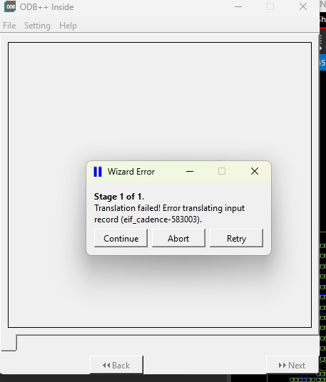

    I wanr export the ODB file, but this error appear

    Last time I saw something about not being able to generate ODB++ was when it was known that the CAD data texts contained truetype fonts..
    The Truetype feature was introduced in the PCB Editor version 25.1 (If I can recall)
    There is a bug in that it is not possible to selct the old type of fonts. The drop-down menu does not work. Instead, the user has to type in the menu text style selection manually, including spaces. A bug report has been filed (by me) but not fixed by cadence so far.
