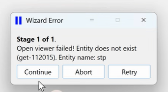

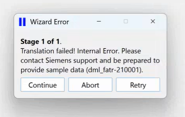

Unable to export ODB++
KK202607082958
KK202607082958 3 months ago
Vesion 23.1
while exporting ODB++ for a particular board below errors appear.
Performed dbdoctor and the brd file doesn;t have any special characters, kindly let me know what could be the issue
Thanks
  • Jeff H
    0 Jeff H 3 months ago
    Do you have a long path to your .brd file?  This is when I typically see this issue.  What version of ODB++ INSIDE do you have?  The current version, v2604, was just on released April 28, 2026 and it is supposed fix:
    EBS-178618 — Translation fails for designs on mapped drives with long path names.
    Resolution: Fixed.
  • KK202607082958
    0 KK202607082958 3 months ago in reply to Jeff H
    Thank you for the reply
    The board file path is not long. And also ODB++ Version is latest.
  • oldmouldy
    0 oldmouldy 3 months ago in reply to KK202607082958
    Check that you can Generate Artwork / Export Gerber. Check the Classes and Subclasses for all the Films and check that you don't have any entries with (null) for the Class, or Subclass, delete (Cut) any of those that you find.
  • oldmouldy
