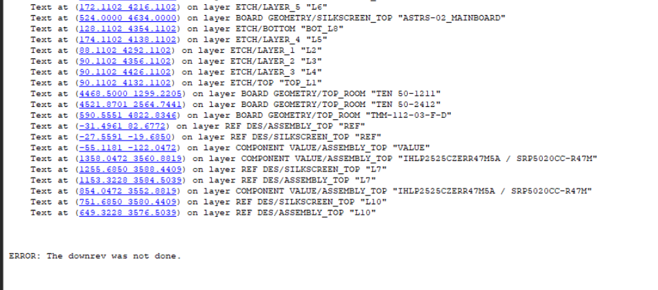

While downconverting from 25.1 to 23.1 below issue appears, I tried to delete all the text but still the issue persists
Kindly let me know if you have any script to run to resolve the issue
Thanks

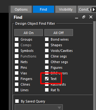

    Hi Siri. Version 25.1 supports font styles that are not compatible with previous versions. Deleting this text is one way to ensure the compatibility, but another one is to simply change the text to "TextBlock". You can do this by right-clicking on the text and choosing "Change TextBlock to".
    So, to double check you've changed all the text, please activate all your layers:
    Then change your Find filter so it's selecting "Text":
    Then window select everything in your design. Now you can right-click and change everything to TextBlock.
