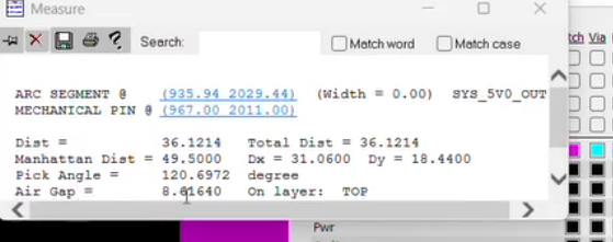

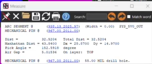

After upgrading from version 16.6 to 24.1, the airgap is getting reduced automatically.
Could you please let me know what could be causing this behaviour? Is there any setting or change in the newer version that could affect the airgap?

    Hi Siri , After the update, have you tried running Database check (Tools > Database Check) once? Also, make sure the shapes are up to date.
    If it is still an issue, I might need to look at the database. Let me know if you can share the database and I can contact you through separate channel.
