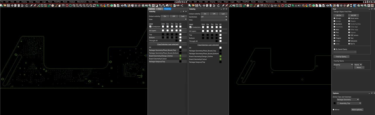

Hi folks
I have one question when generate the NC drill.
Left screen is Allegro 17.4, it works fine. But with same board file and same parameter setting, on the right side 24.1 version, can't see the drill symbol after the NC drill generated.
Open all drill layers, is this something related to version different?
  • steve
    0 steve 21 days ago
    Unfortunately this is a known bug. It's only on the display though, if you export a PDF or artwork film they are displayed.
  • kin2311231
    0 kin2311231 21 days ago in reply to steve
    If it is a know bug, then I have nothing to do with.
    Interesting things is, I asked some other PCB designer and they do not have this issue.
    Seems it might also related to display card?
