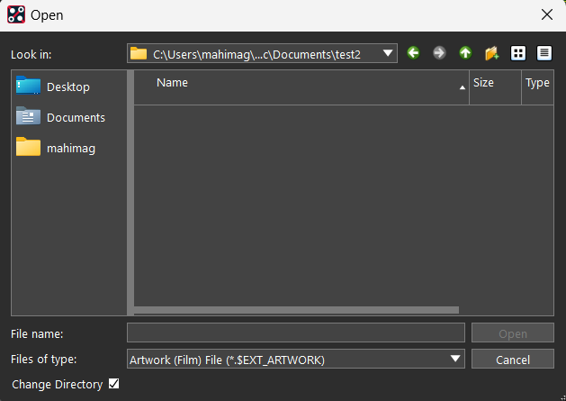

Hello All,
I have a skill that interacts with form to select .art films.
I would like the skill to remember the last browse location without changing the current working directory, until the form is closed.
 (case (myform->curField)
  ("artTopBrowse"
   artFilmTop = axlDMFileBrowse("ALLEGRO_PHOTOPLOT" nil)
   (when artFilmTop
     axlFormSetField(myform "artTop" artFilmTop)
After reviewing the algroskill.pdf, I passed ?noSticky t to the axlDMFileBrowse, but for some reason, it didn't work. Adding ?directorySet t also didn't help.
Does anyone have a solution for this?
Thanks
BR
Samba
  • mahimag
    mahimag over 1 year ago in reply to SambaKantipudi +2 verified
    I have checked this on windows, if you enable change Directory checkbox, this will take you to the last browsed location artFilmTop = axlDMFileBrowse("ALLEGRO_PHOTOPLOT" nil)

    Hello SambaKantipudi , File browser normally remembers the directory from the previous invocation.
    g_noSticky, If t, then it starts the browser in the current working directory. So, if you want the browser to remember last location, you do not need to set this.
    How does it behave without this option? Does it still open the current working directory?

    artFilmTop = axlDMFileBrowse("ALLEGRO_PHOTOPLOT" nil), I currently use this.
    This always open the current working directory. It doesn't remember the directory from the previous invocation.

    can you check for the variable new_filedialog_disable? If this is not set, you get the option of "change directory" in the browser and once you do it, it will remember the change.

    The variable new_filedialog_disable was not set.
  • SambaKantipudi
    0 SambaKantipudi over 1 year ago in reply to SambaKantipudi
    I am running in Linux.
    Are you running on Windows?
    If you can confirm, it's working well on Windows, I would raise a CCR on this.

    +1 mahimag over 1 year ago in reply to SambaKantipudi
