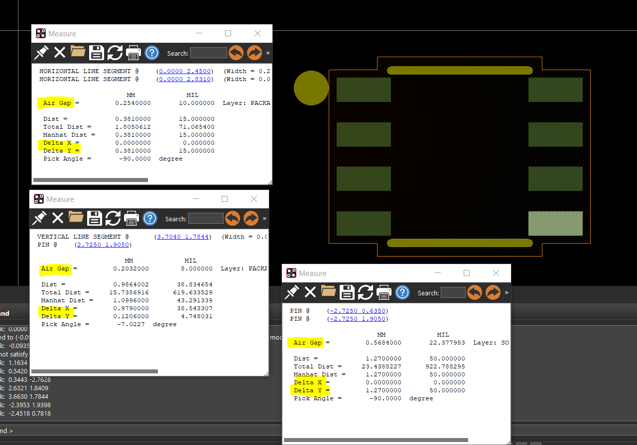

May I know if there is possible way to create a script/skill for measuring all the selected object at the same time? or it can create a report of the following details below. Thanks!

    Since there doesn't appear to be any hook into the 'show measure' command you would need a skill procedure that would:
    select the 1st object & then the 2nd object, then call:
    (Data = (axlAirGap 1st 2nd nil 'enhanced))
    then parse the information from the Data list to output it in whichever format you want...

    Can you please give a example like to measure from placebound edge to line and place bound edge to pin. Thanks!

    the attached zip file contains a simple skill routine
    https://community.cadence.com/cfs-file/__key/communityserver-discussions-components-files/137/my_5F00_measure.zip
    below is the Command>  window entries ( the italic text are my command entries ):
    skill load "my_measure.il"
    t
    skill my_measure()
    Select a place_Bound shape:
    last pick: 1665.00 1315.00
    Select a Pin:
    last pick: 1611.97 1311.01
    Select a ClineSeg:
    last pick: 1614.66 1274.65
    AirGap (nil isEtch nil layer2 "PIN/TOP" layer1 "PACKAGE GEOMETRY/DFA_BOUND_TOP" location1 (1652.0 1302.5) location2 (1620.0 1302.5) airgap 32.0)
    AirGap (nil isEtch t layer2 "PIN/TOP" layer1 "ETCH/TOP" location1 (1610.0 1277.5) location2 (1610.0 1292.5) airgap 15.0)
    t
