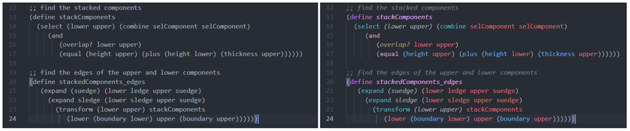

The following image shows a snippet of code with and without highlighting. Microsoft Visual Studio Code, also known as VS Code, is one of the popular text editors. You can do SKILL programming in VS Code due to the third-party extensions. This article talks about how to use SKILL extensions in VS Code.

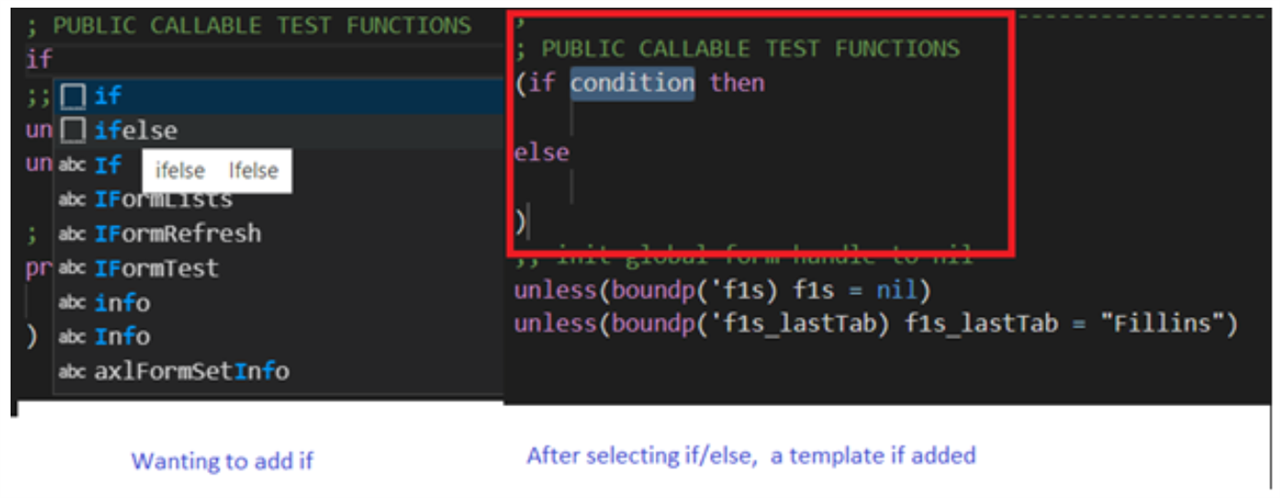

VS Code extensions lets you add languages, debuggers, and tools to different languages to support your development workflow. The extension may provide highlights, snippets, autocomplete with structure templates, code outline, declaration search, and highlighting of errors for example when a variable is not declared. The following image shows autocomplete with a structure template for the 'if' construct in Allegro SKILL.

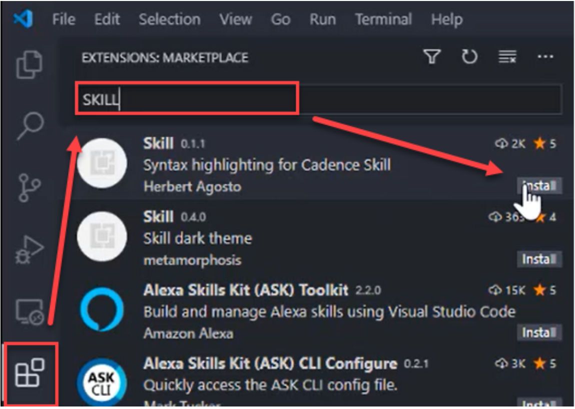

Allegro SKILL extension is available in VS Code Extension Marketplace. You need to search it and install it for VS Code as follows:
You can browse and install extensions from within VS Code. Bring up the Extensions view by clicking on the Extensions icon in the Activity Bar on the side of VS Code or using the View > Extensions command (Ctrl+Shift+X).
This will show you a list of the most popular VS Code extensions on VS Code Marketplace.
Search by typing SKILL.
Choose Skill 0.1.1, Syntax highlighting for Cadence Skill.
Click on Install.
You can now open an Allegro SKILL file (.il) in VS Code.
