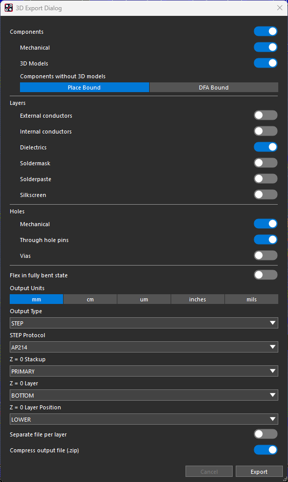

Before 24.1, I wrote a small SKILL procedure to automate Allegro exports. The code is below:
let((t_PnRev b_return)
t_PnRev = buildString(lsGetPnRev("ASY") "_")
when(t_PnRev
b_return = axlRunBatchDBProgram("step_out" strcat("step_out %s -o " t_PnRev "_STP -u MILLIMETER -s \"allegro_" axlVersion('fullVersion) "\" -m -n -d -i -z") ?logfile "step_out")
; delete uncompressed STEP file
b_return = b_return && deleteFile(strcat(t_PnRev "_STP.stp"))
b_return
Even with some of the variables missing I think it's understandable. Unfortunately, this does not work in 24.1, because this batch command has seemingly been eliminated.
As you can see, this previously generated a STEP file in a ZIP archive with mm units using footprint-assigned STEP models and both mechanical and electrical drill holes. This is the format I desire under 24.1.
3d_model_export looks like it might be the new command, as commands with underscores are usually batch commands, but it's not working for me despite trying that command in various ways as described at https://support1.cadence.com/api/CosWeb/TechPubDocViewerCosLite/7135ff3b794b9157e1af5da8d43990ae8de226eb1af6db95212c9e511dc3f1072b60b4b42f9057b34c6390e2e91550b56313d3dd2d651fd2b6620e2f0c1e64eab76cd065a85e412a980228d1015274732333b20c14c29afb68fca737c4868a2cbbb14b57bb7ac03c8a77c47deebebf77b1e55a69332b02b5c9ea83e54ba09b05326b4097cfb607fb2ed369d785e7a51d04e97cbcdbd6ee6f7c2d2e3bd97909afc67908b4fe2ea33e91e74cb2929b2390/Docs/vcoms/vcoms24.1/vcoms.pdf.
I am able to manually configure an export like I want in the new 24.1 3D export UI which seems to match my SKILL code above in previous Allegro versions (noting that the 'Dielectrics' setting is critical to getting the board outline in the export) like this:
But I'm not able to automate this export so far. I could try using a bunch of axlShell commands to automate the Allegro UI, but that seems too lame to try without asking first. Does anyone know how to automate a STEP export under 24.1 like I had in previous Allegro versions using the SKILL code above?

    DE202408202727 over 1 year ago in reply to DE202408202727 +1 verified
    This works for me: axlShell(lsprintf("3d_export ./%s_3D.stp millimeter -eEXPsSk", axlCurrentDesign()))

    Actually, just "3d_export" seems to be the right command. And I can find the output for this command on the Allegro console.
    I tried replacing the batch command above with this:
    b_return = axlRunBatchDBProgram("3d_export" "3d_export test.stp millimeter" ?logfile "3d_export_out")
    But I get a typical complaint about missing "%s" for the default design.
    So then I tried this:
    b_return = axlRunBatchDBProgram("3d_export" "3d_export %s test.stp millimeter" ?logfile "3d_export_out")
    And the command can't be run with a return value of -127. That's as simple of an example as I can think of, before building up the exact options I want. Any ideas?

    Why not just use axlShell?
  • DE202408202727
    +1 DE202408202727 over 1 year ago in reply to DE202408202727
    This works for me:
  • evanshultzlightspeed
    0 evanshultzlightspeed over 1 year ago in reply to DE202408202727
    Hi Dave.
    Thank you. This works for me as well.
    I like the user experience of the axlRunBatchDBProgram and the ability to create a log file, but functionally this is equivalent.
