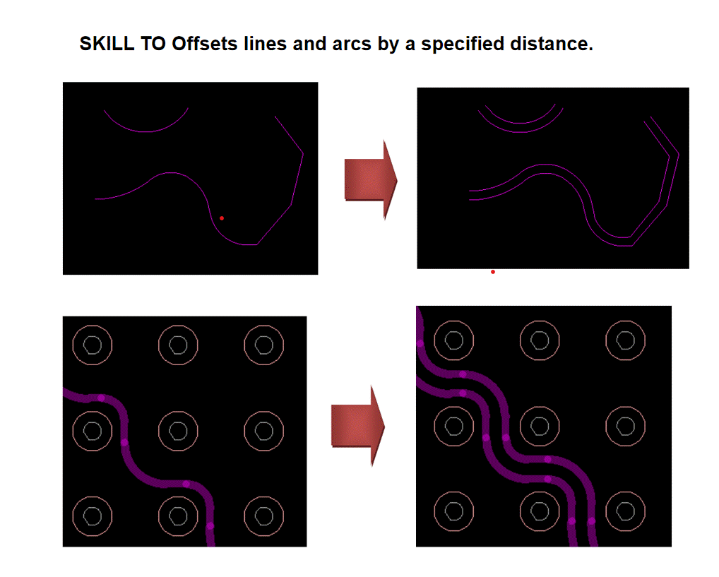

Hi Bro,
would you help to provide the skill which can offsets lines and arcs by a specified distance ,like the following picture show, (the original command offset copy is not good for any angle copy , only support X or Y direction offset copy)
thanks in advanced!
  • Hoangkhoipcb
    Hoangkhoipcb over 1 year ago in reply to Xiaome8 +1 verified
    Hi Xiaome8, you can refer this code. axlCmdRegister ( "offset_line" `offset_line ) ( defun offset_line ( ) axlVisibleLayer ( "anti etch/all" , t ) axlClearSelSet () axlSetFindFilter ( ? enabled…

    0 Xiaome8 over 1 year ago in reply to Hoangkhoipcb
    Hi HoangKhoi ,
    The code has improve as the pattern I mention above, but it is a little strange that the cline width is sometime is 0um width(wrong), sometimes use the one default(right value)
    and the axlUIPrompt dialog box (250 spacing)is always on ,so every time need to put the offset value to replace 250,
    so can you help optimize the offset value can keep the value which user give? thanks again~

    +1 Hoangkhoipcb over 1 year ago in reply to Xiaome8
    Hi Xiaome8,
    Here your the code:
    axlCmdRegister("offset_line" `offset_line)

  • Xiaome8
    Hi HoangKhoi ,
    This one is good ! thanks!
     Niubility!
