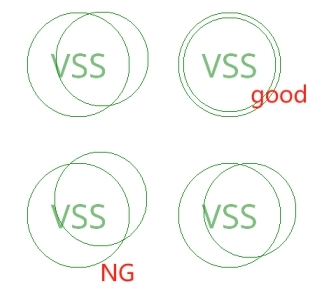

Hi Bro,
Is there a skill to move the via to the pin center automatic when the via and pin are overlap with each others? it is not convenient to move the via to pin center one by one which use the move and snap command.
it would be great if the skill support the bbox select for muti vias align with the pin.

    Hi Friend, You can refer this code. axlCmdRegister("move_via_to_pin" `move_via_to_pin ) (defun move_via_to_pin () axlClearSelSet() axlSetFindFilter(?enabled '(noall VIAS NAMEFORM) ?onButtons '(noall…

    Xiaome8 over 1 year ago in reply to Hoangkhoipcb +1 suggested
    Hi HoangKhoi. WOW, The code works well ,thanks again!

    hi Hoangkhoi,
    In  the  version 1.0 code ,when use move command, the trace which connect to via is not move or  strech with the via ,would you help to fix it? maybe the guy Zpofrp want the slide to replace move for this reason

    0 Hoangkhoipcb 7 months ago in reply to Xiaome8
    Hi Xiaome,
    This version works for your requirement.
        axlShell("setwindow pcb; prepopup 0.0 0.0; done")
        axlCmdRegister("_move_via_to_pin" `__move_via_to_pin ?cmdType "general")
        axlShellPost("_move_via_to_pin"))
    (defun __move_via_to_pin ()
        axlShell("setwindow pcb; prepopup 0.0 0.0; done;setwindow pcb; move;setwindow form.mini;FORM mini stretch YES;setwindow pcb; prepopup 0.0 0.0; done")
        axlSetFindFilter(?enabled '("noall" "VIAS") ?onButtons '("all"))
        mypopup = axlUIPopupDefine(nil (list (list "Done" 'axlFinishEnterFun) (list "Cancel" 'axlCancelEnterFun)))
        axlUIPopupSet( mypopup)
        axlSelect(?prompt "Please select an element...")
        vias = axlGetSelSet()
        axlClearSelSet()
        foreach(via setof(e vias axlDBIsFixed(e->net) == nil && axlDBIsFixed(e) == nil)
            axlSetFindFilter(?enabled '("noall" "PINS") ?onButtons '("all"))
            axlSingleSelectBox(via->bBox)
            pin = car(axlGetSelSet())
            if(pin != nil then
                if(axlGeoPointsEqual(via->xy pin->xy) == nil then
                    axlShellPost(strcat("setwindow pcb; move;" "pick " axlGeo2Str(via->xy) "; pick " axlGeo2Str(pin->xy) ";setwindow pcb; prepopup 0.0 0.0; done;"))
        axlCmdUnregister("_move_via_to_pin")
        if(vias != nil then   axlShell("move_via_to_pin"))
        printf("Last Update: 05/04/2026 -Version 2.0\n" )
    BR,
    HoangKhoi

    0 Xiaome8 7 months ago in reply to Hoangkhoipcb
    hi HoangKhoi,
    The code works well, thanks again !
