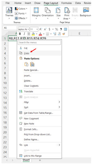

  • Hoangkhoipcb
    Hoangkhoipcb over 1 year ago
    Hello Andak
    Your idea is perfect. I have another idea: use the function axlClipboardGetText() as well—everyone refers to this method.
    Usage:
    load("*.il")
    copy select value Refdes Excel
    type ->cmd  "assign_color_sym"
    axlCmdRegister("assign_color_sym" 'assign_color_sym)
