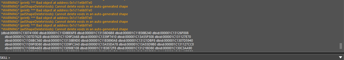

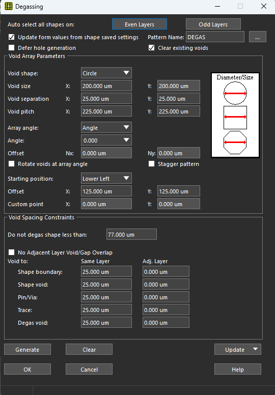

  • AnanthVedalaLM
    0 AnanthVedalaLM over 1 year ago in reply to mahimag
    Hi mahimag , Yes i'm using it to delete these Advanced degassing holes which were placed on the CONDUCOTR Class, using the shape degassing(image attached) tool, if i use axlShapeDeleteVoids() it gives out a warning(image attached). This will only work for Manually placed voids.
  • mahimag
    +1 mahimag over 1 year ago in reply to AnanthVedalaLM
    Hi, Correct API Usage: The axlShapeEraseDegassingHole function is designed for advanced degassing holes, not regular ones. For regular degassing holes, the axlShapeDeleteVoids API should be used.
    Recommended Code:
    axlCmdRegister("del_degas" 'del)
    procedure(del()
    axlSetFindFilter(?enabled '("shapes") ?onButtons '("shapes"))
    axlSelect()
    shape = car(axlGetSelSet())
    void_list = shape->voids
    axlShapeDeleteVoids(shape) ; Pass shape's boundary dbid
