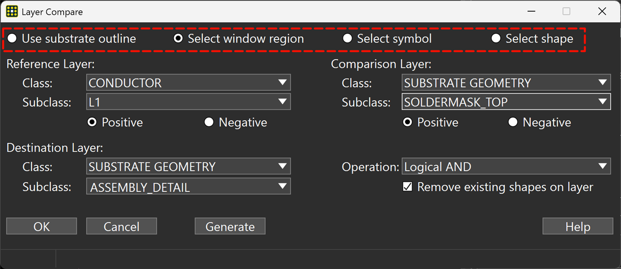

Hi everyone,
I'm new to SKILL and trying to implement something similar to Allegro's built-in selection tool (like the screenshot below).
Could you provide guidance on how to approach this? A complete code example would be extremely helpful if possible.
Thanks in advance!

    Take a look at this:
    Title: Allegro SKILL Reference -- Form Interface Functions - Using Forms Specification Language
    URL: https://support.cadence.com/apex/techpubDocViewerPage?xmlName=algroskill.xml&title=Allegro%20SKILL%20Reference%20--%20Form%20Interface%20Functions%20-%20Using%20Forms%20Specification%20Language&hash=pgfId-480398&c_version=17.4-2019&path=algroskill/algroskill17.4-2019/11frmint.html#pgfId-480398
    and this:
    Article (20159302) Title: Quick reference to SKILL examples on forms, fields and menus
    URL: https://support.cadence.com/apex/ArticleAttachmentPortal?id=a1Od0000000sxKxEAI
    There are plenty of examples in the installation folder. Search for the .form files.
